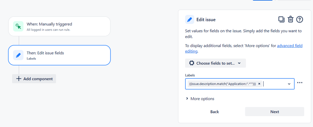

I am trying to get 7 fields from issue description and add them to custom fields:
I have built a test rule to get HIS from Application::"HIS" and add it to Labels:
Unfortunately I am getting the below error:
I guess to get only "HIS", regex should be: Application::"(.*)"
I would appreciate any suggestions on this case.
April 15, 2024
Hi @Mateusz Bajorek -- Welcome to the Atlassian Community!
Your update with the group parenthesis is correct, and you may escape the quotation marks if you do not want those in the result:
{{issue.description.match("Application::\"(.*)\"")}}
Also...do you expect any linefeeds / carriage returns on the description?  If so, it does not handle those well; consider replacing / removing those before the match() call.
Mateusz Bajorek April 15, 2024
Hi @Bill Sheboy
This is exactly what I was looking for. Thank You so much!
Let me create custom fields to check if I can add all the info.
Like # people like this
April 15, 2024
Before you do that...
You can quickly test by using match function calls and only writing to the audit log.  That will save time in getting the correct regular expressions before trying to set the field values.

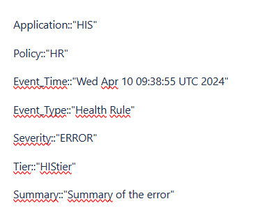

Hi @Kalyan Sattaluri
sure, here it is:
I think I will create text custom fields for each of this section.
Kalyan Sattaluri
April 15, 2024
Please share actual sample text so users can try it and update your original post of this thread so others can take a look as well.
Also, what is your end goal... you say you want to update labels field but you have sentences. You cannot have spaces in your labels right?
I will have to get 7 labels in total from one issue description.
