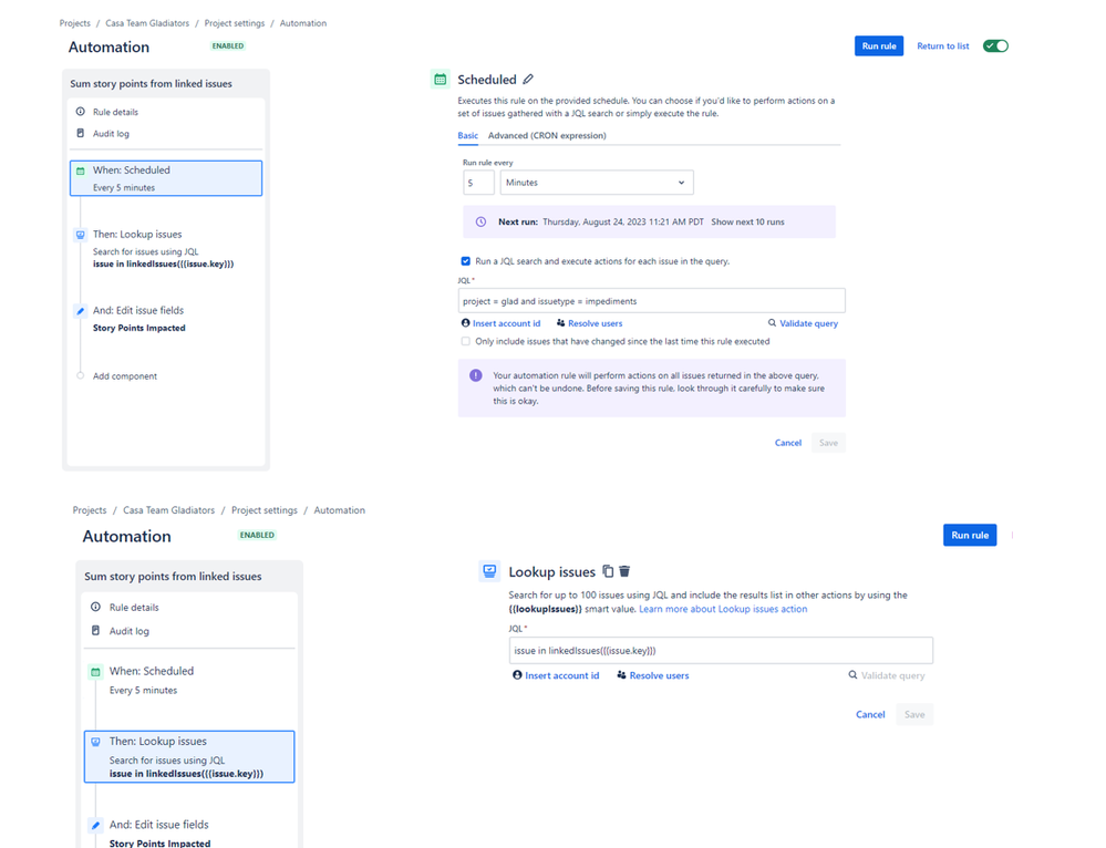

I am creating an automation rule in Jira to sum up all the story points on this linkedissues and to populate a field named "story points impacted".
Details of the rule:

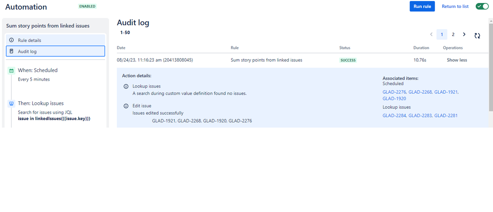

The rule runs and gives a success result:

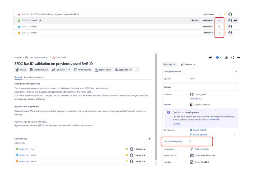

But the field "story points impacted" field is populated as "0".

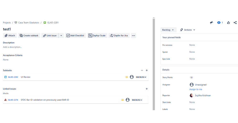

Can you show us a screen image of one of the linked issues showing the Story Points field with its value?

Sure.

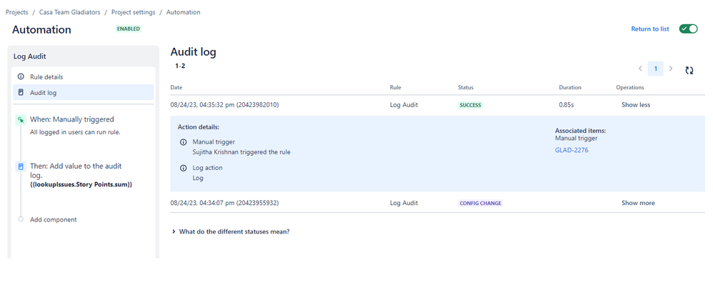

I added a log action into the Audit Log to print the value of {{lookupIssues.Story Points.sum}} and it returns "0".

That will have a value only after you have executed a Lookup Issues action. You need to insert into your rule after that action.

The log file documents that issues are being found by the Lookup, per the notes on the right side. But, just to confirm can you add another Log action after the Lookup to print out
Results count: {{lookupIssues.size}}
Given that the print out of {{lookupIssues.Story Points.sum}} is zero, that is an indication that there is something wrong with your smart value.

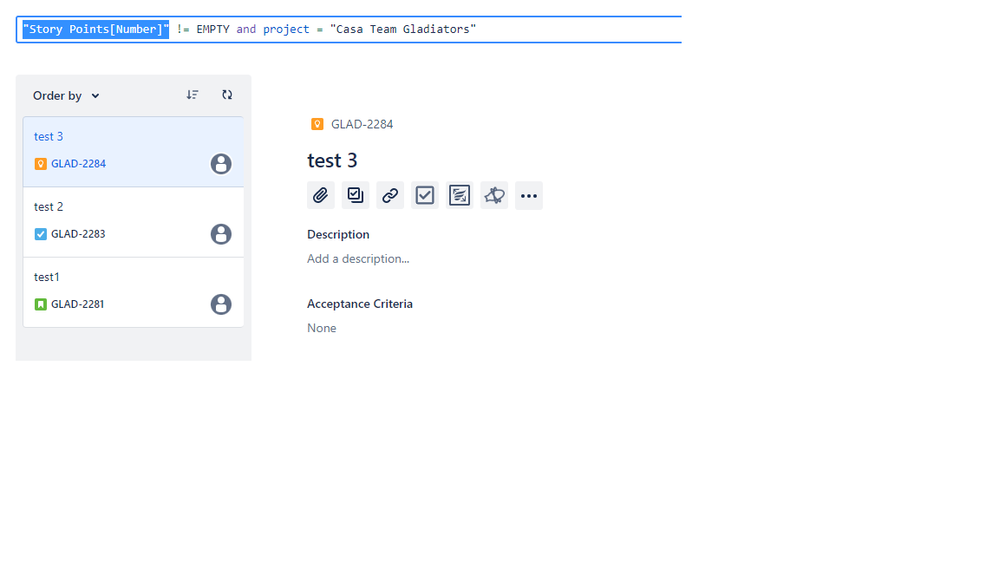

Can you check if there is more than one field named "Story Points" defined for your system? Go to the "View all issues" screen under the filters menu and using the Advanced/JQL view type into the JQL field Story. That will present you a list of possibly matching fields. Is there more than one field named Story Points?

Thanks. Updated the rule to add the log action to print the count and results are as below.
Upon checking the fields, I do see 2 fields with the same name "story points".
Looks like the fieldname is "Story Points[Number]", it filters the items with the story point values.
