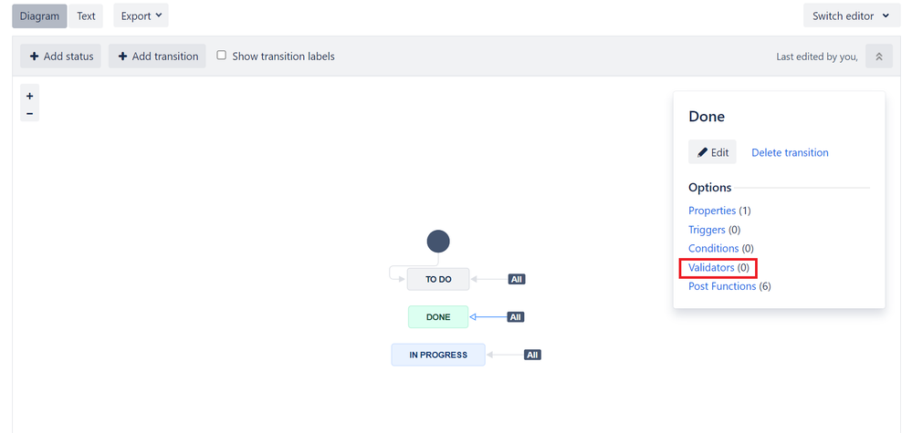

1. Go to the workflow configuration for the selected project
The solution described below is available only in company-managed projects. Moreover, only the Jira project administrators are able to change workflow configuration and therefore add issue transition validators. If your project is company-managed and you have the necessary permissions, you can find the workflow configuration page in the project settings on the left-hand menu. Go there and click the pencil icon next to the workflow scheme assigned to your project and issue types you want to configure validators for.
2. Select appropriate issue transition
Issue transitions are represented by arrows from one ticket status to another. For example, you can have a transition from the “To Do” status to “Done”, as well as a transition from the “In Progress” status to “Done”. Once you have clicked on the transition you want to add validation for, click on the “Validators”.
3. Select the checklists validator
From the list of all available validators, select the “All checklist items are checked”. Once you click “Add” you will be asked to enter the name of a checklist that you want this validator to be applied to. You can also leave this field empty - in that case the validator will be applied to all checklists.

Maxim Filipchyk September 2, 2022
For some reason "Validators" option is not shown when I click on any Status is Workflow Editor.
Please advice.

Hello @Maxim Filipchyk
do you have the complete administrative permissions for your Jira instance? If so, please note that depending on the Jira hosting (Cloud/Server/DC) and Jira version, the options might be placed or look different.
If you are having trouble setting this up, you can always reach our support team here - https://soldevelo.atlassian.net/servicedesk/customer/portal/5
They will guide you through the set-up or may even schedule a call with you to set this up together.
Maxim Filipchyk September 3, 2022
Hello, it's working. I've missed the part that it's shown for transitions and not statuses.
Thanks.
