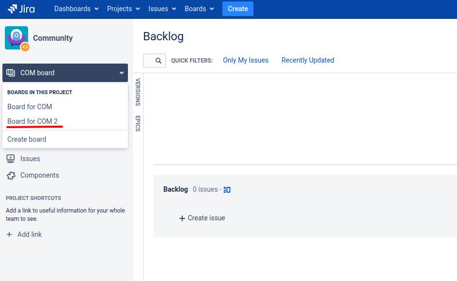

Below is a print screen of the output:-
Your code appears to be failing because you do not have any variable initialised to invoke
sourceIssue.summary
Hope this helps to solve your question :)
