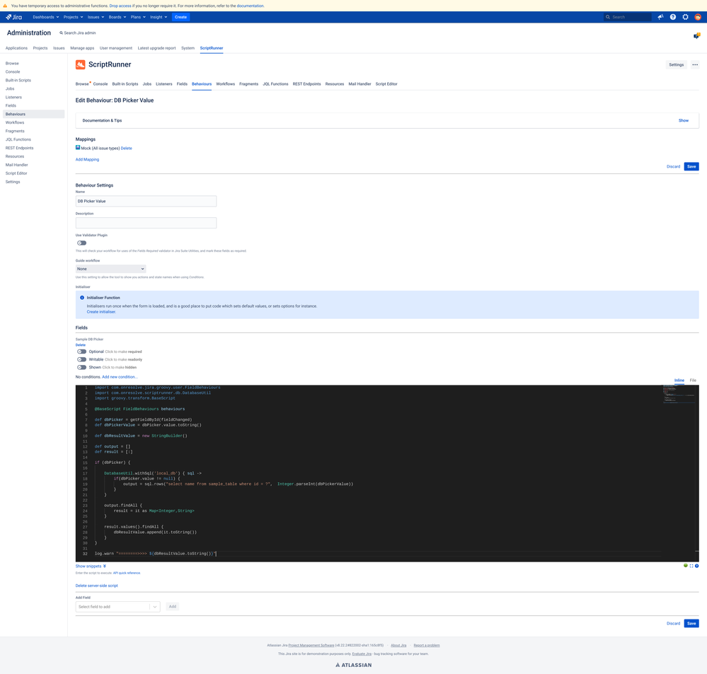

Below is a screenshot of the DB Picker's Server-Side Behaviour configuration:-
The variable local_db that the DatabaseUser object uses refers to the local database configuration that is setup using ScriptRunner's Resources configuration, as shown in the image below:-
Below is a screenshot of the DB Picker configuration that I have tested with:-
In the example above, I am trying to query a table in the database and pass the value selected in the database picker, i.e. the ID, to get the value displayed on Database Picker.
Once the value is obtained, it is stored in a StringBuilder, which is used to set the value in the Summary field.
