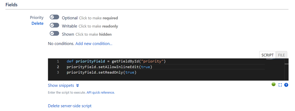

Hi @Jyoti Kumari
You need to apply Behaviour on priority field :-
def priorityField = getFieldById("priority")
priorityField .setAllowInlineEdit(false)
//priorityField.setReadOnly(true)
This script will won't allow editing field from view screen , it opens Edit Screen.

@Vikrant Yadav :- I have tried this, but it is not working as expected.Its behaviour is inconsistent.
Like • Vikrant Yadav likes this
Vikrant Yadav
April 4, 2023
@Jyoti Kumari  I think you applied script at wrong Field. On my side, it's working fine. Edit screen/dialog box is coming, not allowing to Edit Priority from view screen.Edit in Dialog.png Priority.png

@Vikrant Yadav :- Thank you so much, for  the detail Information.There was some issue in one of the project, it is not working for every issue ,so I tested it on different project.It is working fine there.
