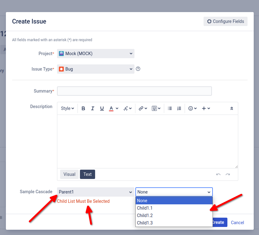

1. When the Cascading Select List has both Parent and Child options, the Validation error message is displayed as expected as shown in the screenshot below:-

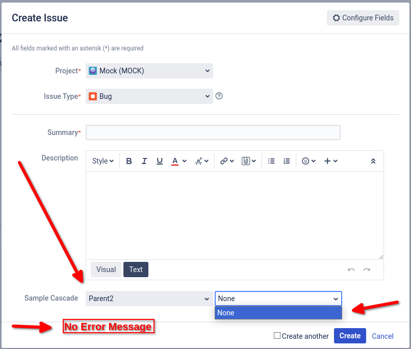

2. If the Cascading Select List only has options from the Parent List and none from the Child List, the error message is not displayed as expected as shown in the screenshot below:-
