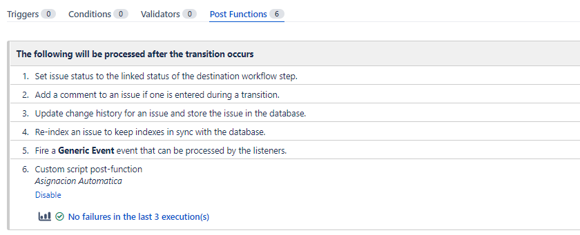

Daniela Buffarini May 10, 2021
Hi @Mohamed Adel OrderInPostFunction.PNG Thanks for your help, I add a screenshot to see the order; I understand that the execution rule that I automate happens first. In what order should it be executed so that it then executes the action of notifying the assigned users?
Mohamed Adel
May 10, 2021
@Daniela Buffarini
Now the problem is that you are trying to assign your issue but the fired issue event is Generic Event and this is not the one you configured your notification scheme for as you configured "Issue Assigned" Event , try to add your assignee script after firing the Generic Event and let's see how this work

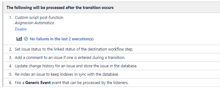

Thanks again @Mohamed Adel . I followed your advice and changed the configuration in this way, but still the notification scheme did not send the mailOrderInPostFunction2.PNG

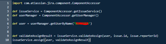

@Daniela Buffarini  good, now let's check your code how you are setting the assignee can you share your custom script
Daniela Buffarini May 10, 2021 edited
Yes.  This the code and assign the user correctly
Text:
def userManager = ComponentAccessor.userManager
def someUser = userManager.getUserByKey("xxxxxxx")
issue.assignee = someUser
Mohamed Adel
May 10, 2021 edited
ok , update your script to be like the one in this thread
https://community.atlassian.com/t5/Jira-questions/Updating-assignee-via-scriptrunner/qaq-p/637155
def issueService = ComponentAccessor.getIssueService()
def userManager = ComponentAccessor.getUserManager()
def user = userManager.getUserByName("tbas")
def validateAssignResult = issueService.validateAssign(user, issue.id, issue.reporterId)
issueService.assign(user, validateAssignResult)

Mohamed Adel
May 10, 2021
also, move your assignee script order to be before the Generic event ,the ordering is not the issue now
Now with this code I try again, but it does not make the change to assign the new user. Assigne remains unchanged. If it was Unassigned, it remains unchanged. Test in both circumstances, with the rule before General Events and with the rule after General Events with the same result. It does not update in assigne. I can not understand how to achieve the assignment and the sending of mail. Coud you keep helping me @Mohamed Adel

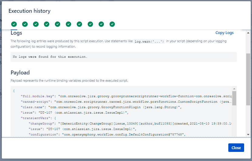

@Daniela Buffarini  is there any error in the script history log?
