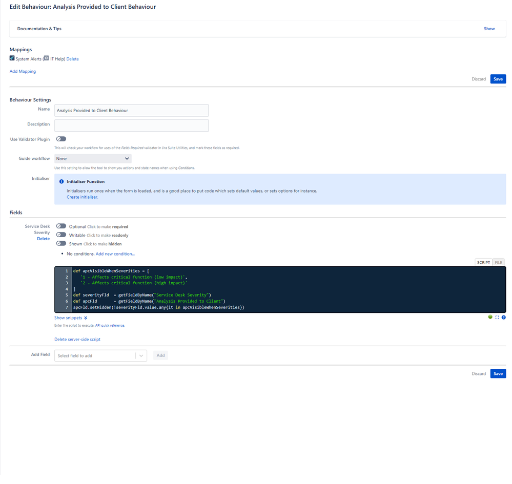

Here is what I meant with that first lines... just to use some debug information
2021-12-17 09_34_44-Edit Behaviour_ test.png2021-12-17 09_36_15-Create Issue - JIRA Dev.png
This gives me some information about what type of data we get from fld.value.
Then when I convert the script I gave you to work with my situation and fieldnames,
I'm able to show/hide my sprint field accordingly
Shown because I selected "products"
Hidden because products or mobile are not selected:
What you have should work. Just make sure the spelling of those severities and field names are correctly matched in the code.

Behaviours on a specific field are executed whenever that field is modified. So you'll want this behaviour code on the Severity field so it fires when you change the severity.
