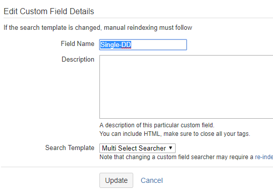

I assume the screenshot shows me how the mentioned event works because I dont understand how that screenshot will help me with my question?

Yes, the screenshot just shows you the event that I said.
