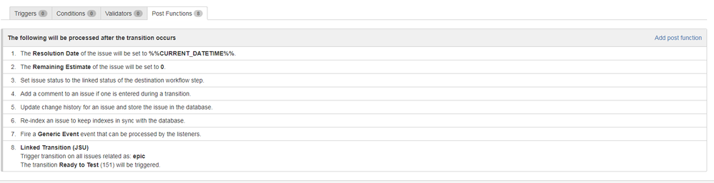

I have two different workflows: one for Epics and another for Requirements that exist as issues with Epics.
In the Requirements workflow, I have added a Linked Transition (JSU) post function on the transition to the Done status that will trigger a specific transition on its Epic when all of its siblings are in the Done status. Basically, whenever all issues within the Epic are Done, move the Epic to a Ready to Test status. I have confirmed that, on its own, this post function executes properly.
However, I have added a ScriptRunner workflow function on the transition in the Epic workflow that is being updated by the Linked Transition post function I mentioned above. This function checks a JQL query and requires that all issues within the Epic are in the Done status in order for the transition to be allowed. I have confirmed that this condition works properly on its own.
My problem is that, once I add the condition to the Epic workflow, the Linked Transition post function no longer executes. My guess is that there is a timing issue where the Epic isn't fully aware that the last issue in the Epic has transitioned to Done status, so it doesn't allow the transition to execute. Afterwards, I can manually transition the Epic to the Ready to Test status.
I have moved the Linked Transition post function all the way to the bottom of the list of post functions (after the issue is stored in the DB and re-indexed), but this doesn't have any effect. Is there a way that I can notify the Epic that all of its children are in Done status while the final child is transitioning to the Done status so the condition is met?

Matt Parks December 18, 2017 edited
 Below are the two screenshots showing the Linked Transition position in the Requirement workflow as well as the details of the function itself.
On the Epic workflow, there is a condition on the transition that is being triggered by the Linked Transition shown above. The condition is met if the Epic matches the following JQL:

Thank you for looking into this and let me know if there is anything else that you need.Post Function Order.PNG Requirement Post Function.PNG

Matt Parks January 2, 2018
I've confirmed that, as long as I don't have the condition on the Epic workflow that checks to see if all of the issues in the Epic are in Done status, the transition works fine, both through the Linked Transition post function or the Script Listener.
Any thoughts as to why the Epic still thinks that the Issue is not in the Done status even though the post function is the last one I execute (after the post functions that store the Issue in the database and re-index)? That seems to be the root cause, as I added some additional logging and the validationResult.isValid() method is not true in the Script Listener.
