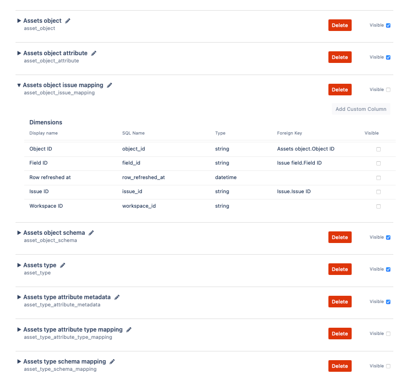

Hi @Tracy Chow ,
Thanks for the helping. I did find the 'asset_object_issue_mapping', and it wasn't ticked on to be available for querying.
However, when I ticked this on and re-sync the scheme, the table was ticked off again.
Am I missing anything?
For reference, I did choose a Limited data connection
Hi Guy,
The "Visible" checkbox on the data source Schema tab determines whether the table is listed in the full schema view.
If a table has the checkbox unchecked, the table will only appear when "Show full schema" is toggled on in the visual mode schema browser. The toggle on the bottom is what I was referring to:
If you toggle it on, you can see all the tables, including the mapping tables. When you sync the schema, it resets back to the default checkbox settings from Atlassian Data Lake. I recommend either not synching the schema frequently or just using the "Show full schema" toggle to access the table.
Hope this clarifies things!
Hi @Tracy Chow ,
Thanks again for your guidance. I've played with it a bit more and realised that the table is available when I tick the boxes for Visible under the Scheme tab and don't click the Sync Scheme button.
It's only when I sync it that the Visible checkbox disappears. I'm not sure if it's meant to do that. Is it due to the Limited data connection I chose when creating the dataset?
Anyway, I can use it now. I appreciate your help and guidance 🙏🏼
Yes, if you hit the "Sync Schema" button it goes back to the default Visible checkbox settings. This is the standard behavior, not only for connections with Limited data. Regardless, there shouldn't be many circumstances where you need to sync the schema.
Glad you can use the new table now! 🙂
