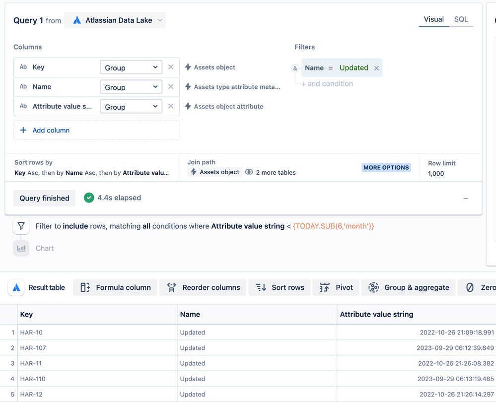

I have a custom date attribute called "Last Reviewed Date" that records the last date that a particular asset object was reviewed.  I would like to create a table in Analytic that list all objects that has not been reviewed in last 6 months.  How do I set the Filters to use a custom date field?

Hi Wong,
In my example, I'm querying the date attribute "Updated", but you can replace it with the name of your custom attribute.
1. First, create a new query and add the Key column from the Assets Object table, the Name column (which is the name of the attribute) from the Assets Type Attribute Metadata table, and the Attribute value string column (which contains the value of the attribute) from the Assets Object Attribute table.
2. Add a filter where Name from the Assets Type Attribute Metadata table = "Updated". In your case, it will be "Last Reviewed Date".
3. Now use a "Filter" step to filter rows where the Attribute value string column is less than {TODAY.SUB(6,'month')}. {TODAY.SUB(6,'month')} is a relative date variable that returns the date 6 months prior to today.
This is what my results look like. Let me know if you have any questions on this!
