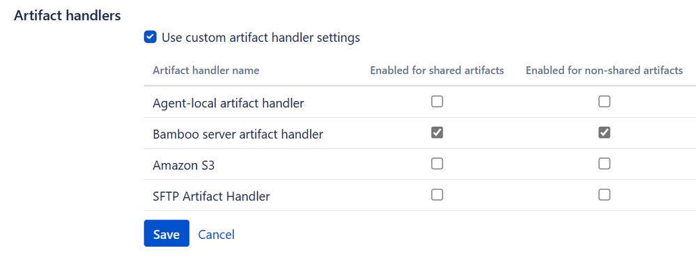

Artifact will only be displayed in the Summary section if while defining the artifact you have selected it to be shared. See below
swati.awate March 10, 2024
It worked. But without checking shared checkbox it had worked on Bamboo server+ remote agent. I was able to generate PDF report on both summary and Artifact section. Why similar configurations did not work for Data center? Why it worked after we checked Shared checkbox?
