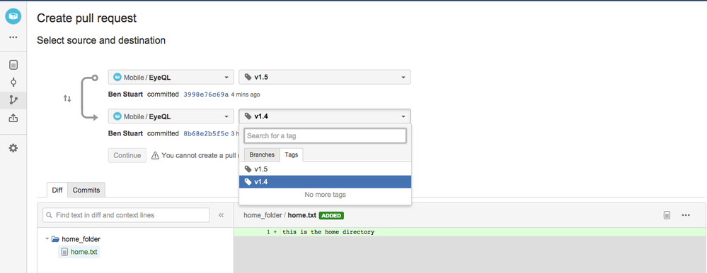

It appears that you're looking for the Bitbucket Server feature request BSERV-2896. The link you posted is for Bitbucket Cloud which is a different code base. I posted a workaround there I think you might find helpful. I'll outline it below:
You can tag commits that you wish to diff and then create a pull request and selecting tags instead of branches.

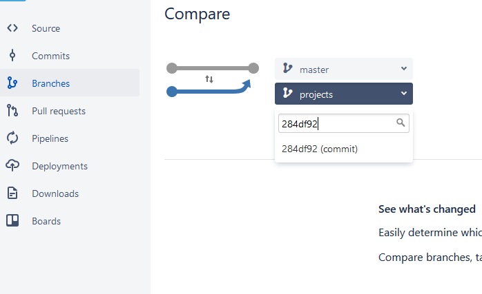

this is so easy to get on github UI ...
Go to compare and past commit id into search field:
