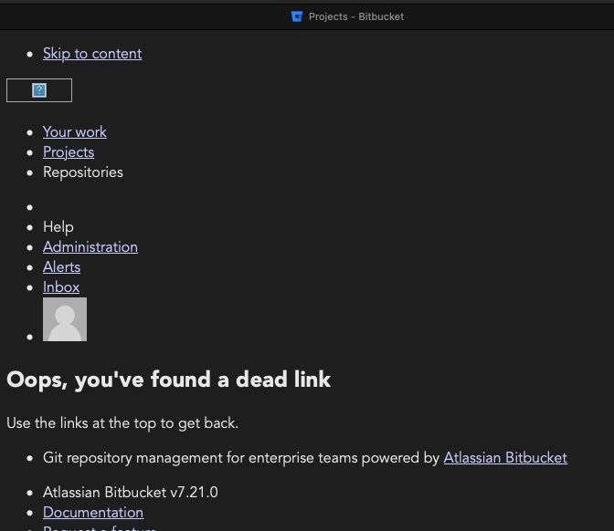

Installed Bitbucket 7.21 on Ubuntu 20.04. Everything works when I directly connect to http://bitbucket.myserver.mytld:7990.
I configured Apache2 reverse proxy and now none of the CSS, img, and JS resources are found, I simply get the plain unadorned html. That indicates that the bitbucket server IS being accessed through the proxy, just none of the resources are there. Comparing the <img src=... and other resource paths with the WebInspector shows that they are identical between a page directly accessed vs. the same page accessed through the proxy.

When you look at the page you are loading in the image above with Dev tools what is the error code and the URL of the resources that fail to load?
Hopefully that will guide you. Is it a 403 or a 404?
Is the URL a legitimate URL?
Given you are also seeing "Oops you found a dead link" indicates the context may be work.
Have a look at the  setup in your ${JIRA_INSTALL}/conf/server.xmlas well.
rucotec April 21, 2022
here is one such url copied from the web inspector.
http://bitbucket.myserver.mytld/s/-888238628/6dea001/n1cn5w/1.0/_/download/resources/com.atlassian.bitbucket.server.bitbucket-webpack-INTERNAL:bitbucket-logo/images/logo/bitbucket.svg
The url is identical for direct connect to 7990 as well as for the proxy connection. Connecting through the proxy gives a 404 not found, direct connect shows the bitbucket.svg logo. Same issue for everything that is referenced from the html like img, scripts, css etc.
