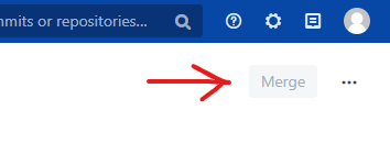

The approach you suggested (If I got it right), accepts or rejects the option to proceed from the Pull Request page to the Merge page (by enabling/disabling the 'Merge' button):
I need something slightly different.

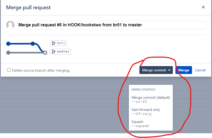

I would like to control the possible merge strategies in the drop-down menu once in the merge page.
Is there a way to achieve this?

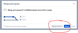

talg1978 April 6, 2022 edited
Thanks @Ulrich Kuhnhardt _IzymesCo_
Right, I got this.
The thing is "preUpdate" is executed when clicking the merge button on the PR page.
At this stage - there is no selected strategy at all, because we select it on the merge dialog box which pops up afterwards:
Returning:
RepositoryHookResult.rejected('reason', 'description')
by the 'preUpdate' method cannot rely on the merge strategy simply because there is none selected at this point (it is 'Optional.Empty' at this point).
Maybe I'm using the wrong method? Is there a method which is executed once actually triggering the merge in the merge dialog box?
BR, Tal
