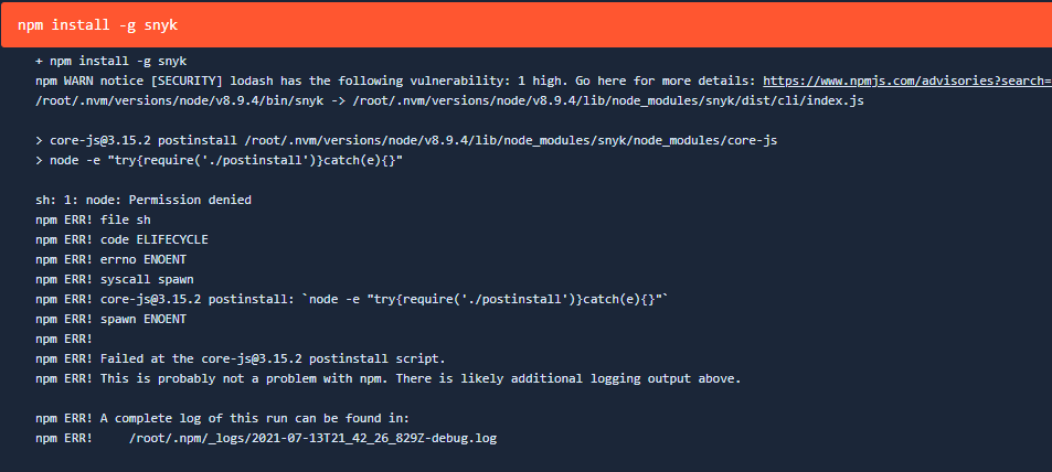

Issue 1: When trying to install snyk using npm install -g snyk command I'm getting the below error

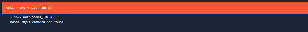

Issue: When I use the command npm install snyk , snyk is installed , but not recognised

Sanju Ammu July 20, 2021
Issue is fixed by adding the below 2 lines of code.
- npm config set user 0
- npm config set unsafe-perm true
