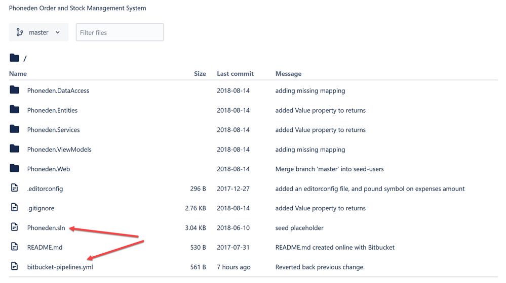

I am new a total n00b to DevOps, but I have heard that BitBucket's pipline feature makes things super easy, so I thought I would try it.
I have created the bitbucket-pipelines.yml file at the root my repository.
But I am getting an error when my pipline runs. The yml file has this:

The message I get when the pipeline fails is:
MSBUILD : error MSB1009: Project file does not exist.
Switch: Phoneden
I assume by Project file, it is talking about the solution file, and you can see from my screenshot that it does exist!
I'm confused. Any help would be greatly appreciated.
Thank you.
Vedran Mandić
September 26, 2018 edited
+1 I have the same question, seems like point to a sln file has no effect? I managed to make it build by pointing directly to my core csproj like dotnet build ./src/MyCoreApp/MyCoreApp.csproj
I guess this is up to the SDK on the image installed, buuuut its the latest 2.1.402 (at the moment of writing) so not so sure after all. You can check that out with dotnet --info in the pipeline script step
Ciwan October 26, 2018
I got it to work by adding the `.sln` extension.

Albert Gaytkulov
July 7, 2020
/opt/atlassian/pipelines/agent/build/"ProjectSolutionName"/"ProjectName".csproj
ONLY THIS helped me. Enjoy =)
