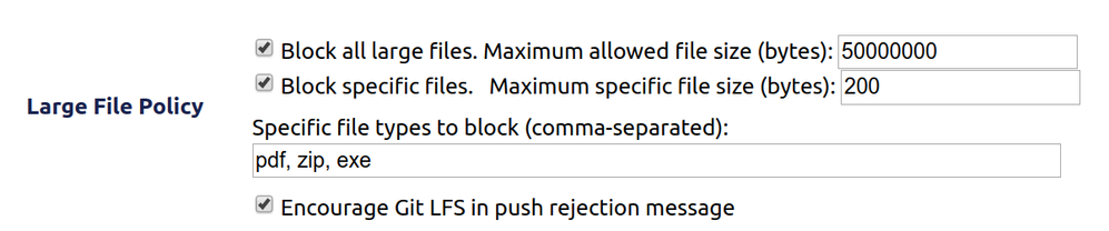

I could add an additional filter to my free Control-Freak plugin.  Right now it does this:
[x] - Block large files. Maximum allowed file size (bytes): [     ]
[x] - Encourage Git LFS in push rejection message.
I *could* add the following control:
[x] - Only block large files that end in the following extensions: [ <comma-separated> ] (e.g., *.zip, *.exe, *.pdf, *.jar)
Is that what you need?  Note: files that fall below (or equal) to the threshold would never be blocked, even if they had the bad file extension. Set the threshold to zero to completely ban that file type.

Okay!  Done!  Look for v2019.10.20 of Control Freak in marketplace.atlassian.com.
Screenshot:
Consequence for a push with large files:
remote: Control Freak
remote: -----
remote: Push rejected.
remote: All files larger than 10 bytes are not permitted.
remote: Specific files [*.exe, *.pdf, *.zip] larger than 5 bytes are also not permitted.
remote: The following files are too large:
remote:
remote: binary/f.exe (7 bytes)
remote: binary/g.zip (7 bytes)
remote:
remote: You can push large files to this repository using 'git lfs':
remote: git lfs track <path>
remote:

I am unable to block specific file types from pushing to the central repository.
Though there's an option to block certain file types as below. But it's not working at all.
I tried with *.pdf and pdf and .pdf conventions. But nothing is working. Still, I am able to commit pdf files to the repository without any trouble.
undefined
But this plugin is able to block larger files but not specific file types.
Any alternate plugin, incase if this plugin can't do this job ?

Julius Davies [bit-booster.com]
April 9, 2020 edited
Are you sure?  This is working for me (I'm the primary maintainer of this plugin):
remote: Control Freak: Push rejected.
remote:
remote: -----
remote: All files larger than 500 bytes are not permitted.
remote: Specific files [*.exe, *.pdf, *.zip] larger than 200 bytes are also not permitted.
remote: The following file is too large:
remote:
remote: test.pdf (1723760 bytes)
remote:
remote:
There is one important loophole to know about with this control:  any file that already exists in the repo (on any branch or tag, including unreachable tags or branches, and including files deleted many commits ago - they are still present in the repo) cannot be blocked (based on contents, not based on filename).  The control only gets triggered during the phase where git-receive is calculating missing files to accept during the push, and since git-receive skips files that already exist on the server, regardless of their name, there is no way to block those.
This means developers can also easily get around the control:  "git push random-file.allowed" and then rename to "random-file.pdf" in a later push.
Is there any chance you guys are hitting against this loophole, where byte-for-byte identical files (regardless of name) cannot be blocked if they are already present in bitbucket?
April 9, 2020
p.s.  the control happily accepts all of these:  pdf, .pdf, *.pdf
(they all evaluate to the same file type)
Jean-Pol Landrain April 14, 2020
I have done a few more tests this morning and in my case it's possible I was into this loophole in my previous tests.
Please, note however that if you don't specify a maximum size (it is not very clear that it is a mandatory field), I believe it should take a size of '0' bytes as default. I don't know if there is a default size at the moment, but it doesn't seem to block anything unless you specify the size (also there is just one pattern both for the filename and for the size; this limits the possibilities).
You say above that all the pdf, .pdf, and *.pdf evaluate to the same file type. Could you also indicate if it is possible to use more complex patterns or even regular expressions ? Thank you.
I know this addition is not very old in the Control Freak plugin, and I just try to suggest improvements. This is not criticism, only suggestions.
Thank you very much for your work on this feature, and on this plugin in general.
