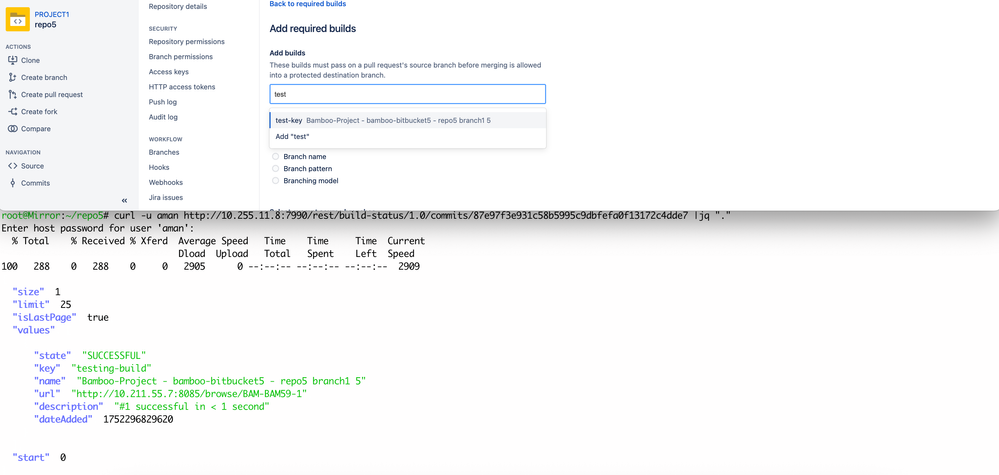

I got the same build keys when running the command:
curl -u {user}:{pass} https://{bitbucket_server}/rest/build-status/1.0/commits/{commit_hash}

I want to clarify that the build key you obtain from the endpoint "https://{bitbucket_server}/rest/build-status/1.0/commits/{commit_hash}" does not correspond directly to the key that Bitbucket shows on the required builds page. Instead, the build key displayed by Bitbucket is derived from the parent field in the build result response. Although they are often the same, they can differ. I can provide an example from my local setup to demonstrate the difference.
Ensure that your CI/CD system uses the newer endpoint so it populates all the relevant data and whatever value it is sending in the parent field is what you can define in required builds page.
