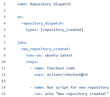

When using a template with a webhook added, I get a 'Couldn't invoke webhook error'.
It appears that the webhook that can be added when creating a Compass template is not able to submit data with the structure we are looking for.
We believe this is why we are getting a 'Couldn't invoke webhook error'.
Specifically, we want to trigger a webhook event called repository_dispatch as shown in the image.
According to the GitHub documentation, the body parameter must have an event_type.
Below is the current structure and the structure we are looking for.
Is there any way to resolve this issue?

@Ryunosuke Kaichi I hear you; the format of the outbound webhook call that Compass makes wraps the user-input parameters under a top-level "parameters" field.
There isn't currently an in-Compass alternative to change that nesting. However, if you set up your own Webhook handler implementation (which is more or less what the example video is doing) you can remap Compass' parameters inside that handler, and then call a GitHub webhook with the structure that it would be expecting. I understand this requires you to build that intermediate handler, but it would give you full control regarding the forwarded data as well.
