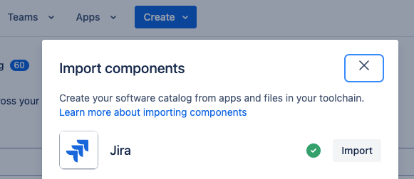

If your site would meet the requirements for the GitHub for Atlassian integration, all you need to do is to provision a new Compass site and complete the onboarding flow - if your Jira projects are already connected with your GitHub instance, you'll see some of them imported from the beginning and starting to receive events and subsequently metric and health scorecard value updates.
You can also keep adding new connected Compass Components to your site using the Create > Import Components > Jira > Import option of your Compass instance.
