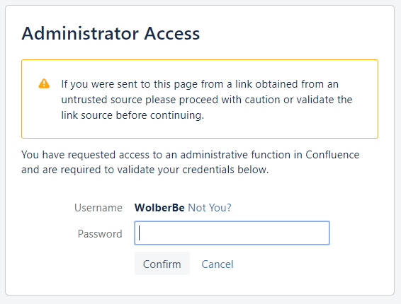

When I'm doing backup from the Admin site, logging in to Confluence requires credentials....
....and when accessing the Settings-section, I am prompted for Admin-credentials.
Might it be the case that the authorization fails as a second log in "as Administrator" is required?
I have tried to log in as administrator (above) and then, in the same browser session (to share the token), execute the backup.action URL. But also this results in the page not found exception above.

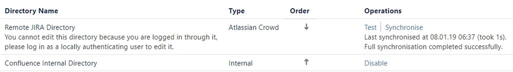

As the login page does not make a redirect after login, my feeling was that this might be related to the underlying user-directory. So I had a check for there.
Currently, our Confluence refers to JIRA, the built in Confluence directory is created, but disabled.
As a test, I have unchecked the "External user management" (in order to get the internal Confluence directory working), changed the order of the two directories (1. Confluence, 2. JIRA), and created a new user within the internal Confluence Directory.
Then, having this user, I tried to proceed the steps mentioned above (log in to http://192.168.41.12:8090 - http://confluence.company.com). But the situation remains the same. After providing credentials, there is no additional action.
Logging in to Confluence normally with this user is possible without problems.
Regards, Benjamin
