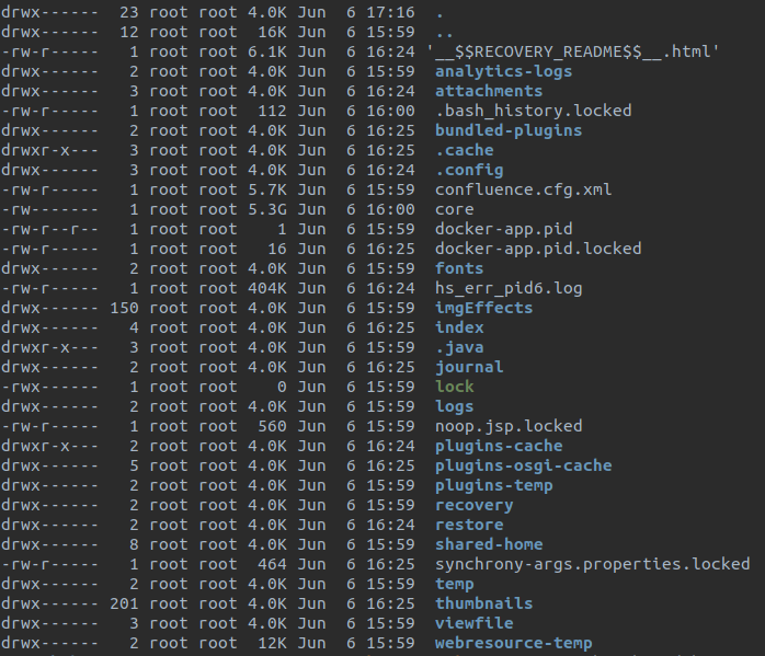

found files named as '__$$RECOVERY_README$$__.html' in home directory
with part of content like
<p>Can't you find the necessary files?<br>Is the content of your files not readable?</p>
<p>It is normal because the files' names and the data in your files have been encrypted by "Cer&#98;er&nbsp;Rans&#111;mware".</p>
<p>It means your files are NOT damaged! Your files are modified only. This modification is reversible.<br>From now it is not possible to use your files until they will be decrypted.</p>
<p>The only way to decrypt your files safely is to buy the special decryption software "Cer&#98;er&nbsp;Decryptor".</p>
<p>Any attempts to restore your files with the third-party software will be fatal for your files!</p>
<p>We have also downloaded a lot of private data from your network.<br>If you do not contact us in a 30 days, we will post information about your private data on public news webs.</p>

are u sure about vulnerability doesn't imply data loss. ?
skhristy June 6, 2022 edited
all files in home directory are prefixed with ".locked" (e.g. index.locked) which means they are encrypted
it seems that the vulnerability does imply data loss
@Fabio Racobaldo _Herzum_ if interested, can attach files from home directory

please could you share a screenshot of your home folder files?
skhristy June 7, 2022
June 7, 2022
I'm sorry but your server has been attacked by some ransomware virus (https://community.atlassian.com/t5/Confluence-questions/We-re-hit-by-Cerber-ransomware-help-needed/qaq-p/1909853
This is not a Confluence issue.
