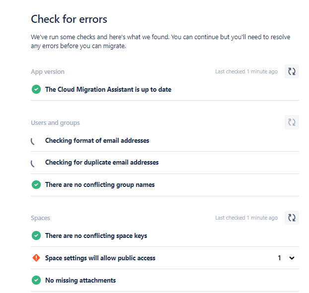

Hello
I am using confluence server Confluence 7.13.2 and confluence cloud migration assistant  Version: 3.3.2
I connect to confluence using a proxied URL
I take following steps from Migration Assistant home
3. MIGRATE YOUR DATA --> Migrations dashboard --> Create new migration --> connect to cloud --> Name your migration* + Choose your destination cloud site* --> Choose what to migrate --> select (spaces + users related to selected spaces + none  apps ) - Then I choose the spaces to migrate using checkboxes  -->Click on Add to migration
At this juncture  or earlier I start seeing pop ups "we cant communicate to your server:" and the  "check for error" screen hangs forever with the items  "checking format of email address" and "checking for duplicate ..." going round in circles .
See attached pictures below

Since I am presently stuck _ I tried this workaround
I looked at https://community.atlassian.com/t5/Confluence-questions/App-Migration-to-cloud-We-can-t-communicate-with-your-server/qaq-p/1825437
And I tried  a dark feature in Confluence Server to test my migration
https://developer.atlassian.com/platform/app-migration/testing/dev-mode/
As per that I enabled "migration-assistant.app-migration.dev-mode"
However even the Dev mode does not seem to help me
So based on discussions with @Pramodh M   we figured the most likely cause to be that I am running confluence from behind a proxy and I ran the migration tool accessing confluence through a proxied URL .
So to eliminate that factor, I ran  migration tool  accessing Atlassian using a direct URL I made some headway .
While I continue to get message as follows I am able to create a migration
So moral of the story --
The migration assistant  Version: 3.3.2 should be used from direct URL
It Will not work behind a proxied URL
for more details,  see discussion with @Pramodh M  below

yogesh_devi
January 19, 2022 edited
Hi @Pramodh M  - Our Confluence sits behind a proxy server ( proxy is a google load balancer) . Base URL uses domain name of  proxy server and points to proxy server (which has a SSL cert for the URL with that domain name.) The proxy redirects to back end confluence server  based on context (/confluence)
The confluence functionality has been working fine for years now  with this proxied base URL.
What is your take given this fact ?
Would you suggest that I access confluence directly from the subnet where confluence sits - albeit that would be using confluence native URL using its IP address,  which is NOT the base URL . Would that work in your opinion

yogesh_devi
January 20, 2022
The problem with that is  that the Base URL change will affect our users across the globe - It will mean confluence downtime from user perspective. Would you suggest that I clone confluence for sake of migration,
But quite honestly ; to me it seems like migration assistant is making assumptions that aren't in accordance with regular product behavior ; can you take this back to the team that develops or supports migration assistant ?

yogesh_devi
January 21, 2022 edited
Hi @Pramodh M
Yes with accessing the confluence from direct URL ( bypassing the proxy )  following happened
I continue to see "We cant communicate to your server"
However ignoring that message and also ignoring warnings owing to "incorrect base URL"
I could finally get to a blank  "Check for errors" screen on which I see a "No blocking errors found" message and "review Migration " button enabled .
See below
So looks like I am past this  stumbling block
You have to use direct URL
Thanks for all your help
