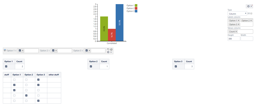

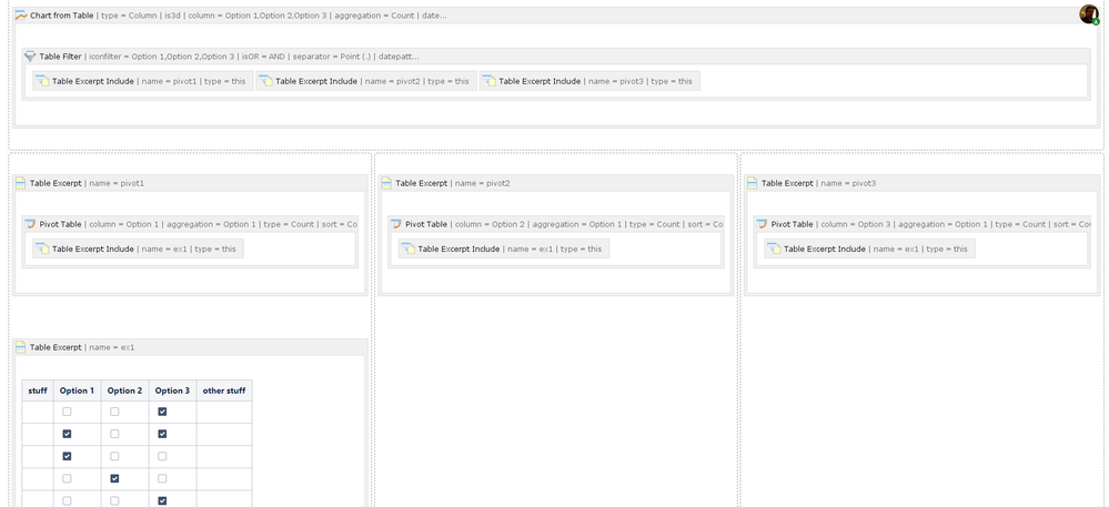

  1. Count number of checked options: 2019-02-21_22h09_44.png 2019-02-21_22h10_47.png 2019-02-21_22h09_56.png
  2. Create a chart to compare number of checked options: 2019-02-21_22h16_04.png 2019-02-21_22h16_40.png 2019-02-21_22h24_13.png
  3. And so on...

Please, take a look at these screenshots:
I use Table Filter macro to filter Pivot Table macros by checked option only: add visual filters for each option and choose checked checkbox in each filter.
Like • 2 people like this
