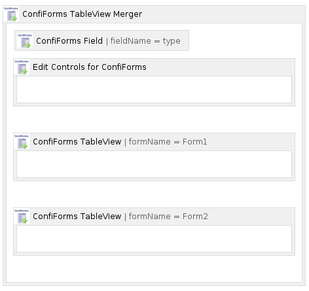

Here's what I did: I wrapped two TableView macros with the TableView Merger macro. This would be intuitive in my opinion. Unfortunately, the result was not as expected.
I have tried some of the settings in the TableView Merger macro, but without success.
And just to clarify what I expected (unfortunately only obtained by editing the above image):
Ulrik Schoth
April 18, 2023
A colleague showed me what was wrong in my code: I just had to empty the body of the TableView macros and put the Field and Edit Controls macros directly into the body of the Table Merger macro.
So, instead of using this code:
I just have to use the code below and everything works as expected:
Since I have always used the TableView macro in the past with field and edit control macros in its body, I would never have thought of this! I was not even aware that you could use the TableView macro with an empty body. 🤦‍♂️
