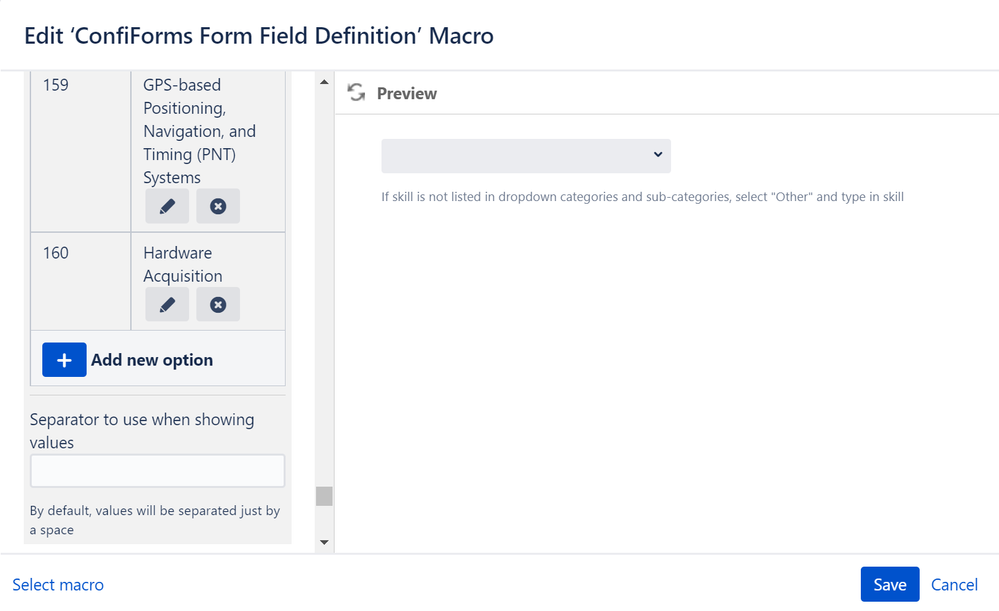

I would like to populate a confiforms multi-select macro from a csv file. I have made these dropdowns before and they work great with the ability to type search and collect results, but I have a single column with about 500 entries and using the macro is taking a long time and as I reach roughly 150 I am noticing the macro choking when trying to save (it just spins and when saving or updating the page it doesn't take).
I having a hard time trying to find out how to take the list I have and essentially drop it into the confiforms macro for multi-select. Is this possible? The manual way is rough to say the least and I actually don't know if that many entries is a culprit of the slow response times. Thank you for any help you can offer!
Edit: To add a little more about what I'm trying to do:
I am having users enter in their skill sets and using a huge list of potential choices in a form that they can submit. Smaller dropdowns and multi-select have worked fine in the past, but I haven't had a list this big before. I came back after a few hours and it's still very sluggish and I can't seem to get past 160 entries but I'm not sure if this is a limitation of the macro. Also added some images for clarity in case I am using the wrong syntax in describing what I am using. Thanks again.
This is what I see when I try to save:
Here is the settings (multi-select)
Here is all I am able to get in the macro (160):

Most probably you hit the limits on the macro parameter length that Confluence has (never seen this documented though)
Overall it is not a good method to put so many options into the configuration
Much better approach is to use OTHER form to import you data and then use it in the current form via Smart fields or using the CSV directly (basically a "web-service" like field)
This one is about excel file to be used as a source for ConfiForms field - https://wiki.vertuna.com/display/CONFIFORMS/Using+Excel+files+as+sources+for+ConfiForms+fields
But the 1st mentioned approach to use ANOTHER for keeping and managing choices in your field is a much better approach
