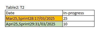

Hihi,
I had two tables as below(T1&T2), the date of both table is shown with "MMMYY,SPRINTxxx"(such as JAN25,Sprint23:06/01/2025), now i want the result display with Date MMMYY(such as Jan25) with the data of each month accordingly, order by MMMYY. i had tried the SQL below via using table transfomer in confluence, but it only show the data of T1 and Mar25 of T2, and did not show the DATA of Apr25 of T2, also the order is not sequence by data. Can somebody please help on it? Thank you so much.

It looks like the main problem comes from the WHERE clause and how the labels are referenced. Using SUBSTR(T3.'Labels',1,5)!="Total" may exclude rows where T3 is null, which could be why Apr25 from T2 isn't showing up.
Here’s a revised version of the SQL, which keeps the filter for "Total" but avoids dropping months from T2:

Oujy_lala April 8, 2025 edited
Hi @Melbrin NGOUILOU_Andemex , thank you! I had tested the revised SQL, it works, now i can see the data of Apr also.
But there is another problem is that the order is not by 'Date', it shown like Feb25, Apr25, Jan25, Mar25, something like this.   looks like the SQL below did not effective...any idea?

There may be some conflict between the ORDER BY and GROUP BY portions of the query. To deal with this, you can try the following query:

Oujy_lala April 11, 2025
Hi @Daniel Berežnoi
Thank you so much, now it works !!!
