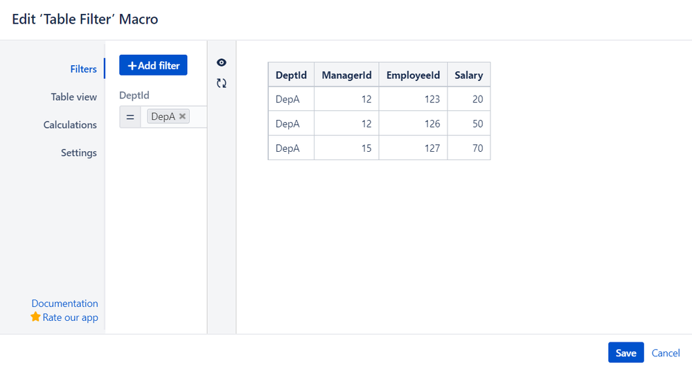

Please navigate to the page edit mode and enter the Table Filter macro settings:

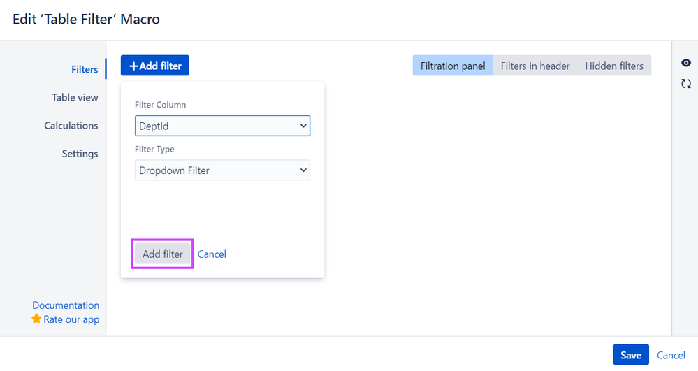

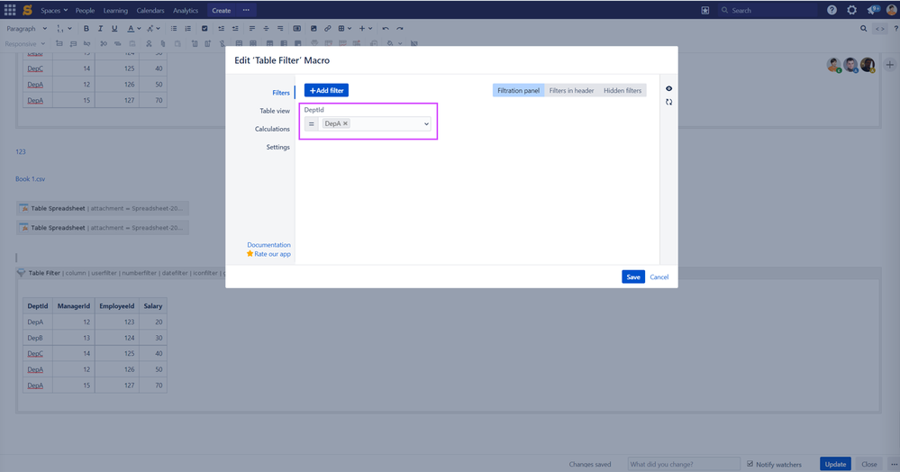

Go to the “Filters” tab, click the “+Add filter” option and select the required filters for correspondent columns.
Then put the needed default values for your filters.

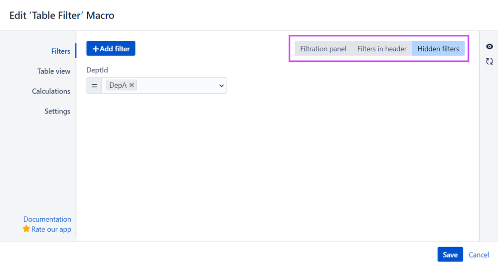

If you don’t want your colleagues to ruin your default filters from the page view mode, you may choose the “Hidden” state of the filtration panel.
