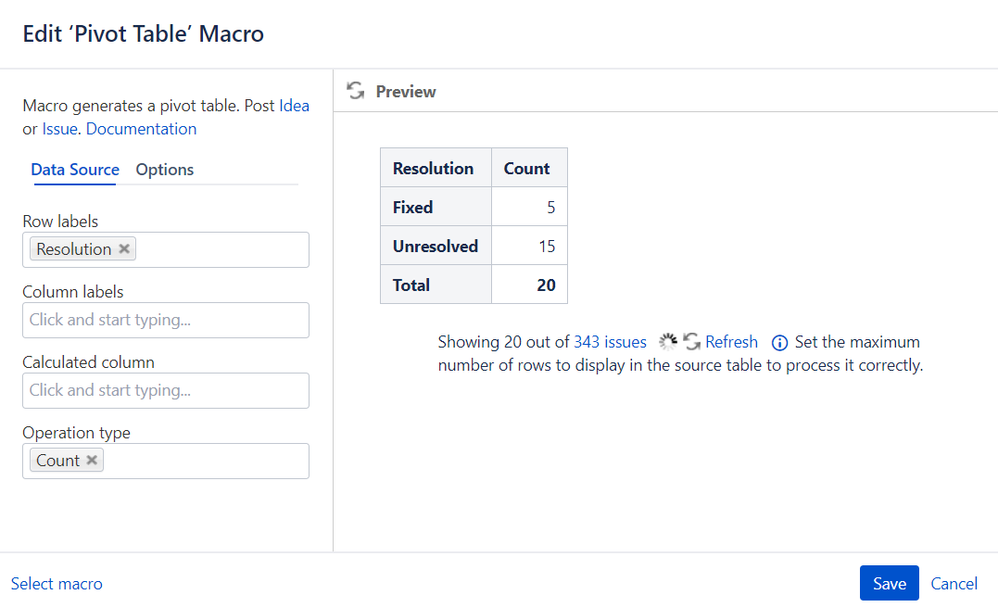

You may try the Table Filter and Charts for Confluence app.
Insert the Jira Issues macro and paste the required JQL (for example, issues that were created and issues that were closed during the last 30 days - it seems, that you need to do something similar).

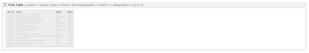

To count the issues of both types, wrap the Jira Issues macro into the Pivot Table macro:
As a result, you'll get a dynamically changing summary table.
You'll be also able to visualize the table with the help of the Chart from Table macro if required. This macro also works with dynamically changing Jira Issues macro perfectly well.

Hi @Lawrence ,
You should insert the Pivot Table macro first on the page, then put you mouse cursor inside the macro body and insert the Jira Issues macro.
So, the Jira Issues macro will be wrapped into the Pivot Table macro.
And, of course, you'll be able to enter their settings separately.
