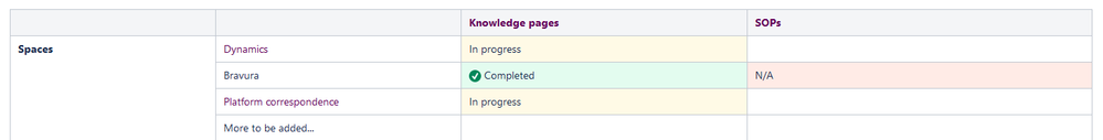

Never mind, I found the solution. It won't apply to the OP here based on the screenshot, but in case it's useful to others:
if a table has a Heading Column, none of the columns can be sorted. If you need to be able to sort, remove that setting for any columns that have it enabled on that table.

Khloe Salmon October 11, 2022
Hi Fabio,
Thanks for looking at this!
It's Data center version 7.18.2.
Here's a screenshot of a table as an example - normally I'd expect to see little arrows next to 'Knowledge pages' and 'SOPs' where I can sort.
Many thanks,
Khloe
