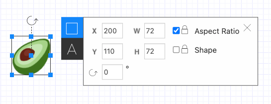

When you select the shape and then click the "Edit Shape Properties" menu (the square), you should be able to unclick the aspect ratio and manually set your shape to the correct width and height.
Hope that helps for the time-being!
Samie
