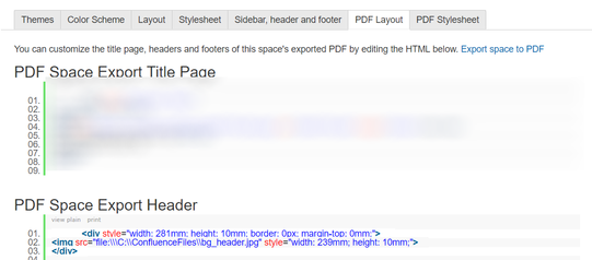

Martin_Nitschke July 11, 2018
Hi Patrick.
As you can see on this picture:
I added the code in PDF Layout in the Header section as described under you provided link under "Adding Images to Headers and Footers". This works in 6.6.0 but on in 6.10.0.
Best regards
