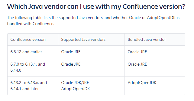

According the version support by Confluence, AdoptOpenJDK supports AdoptOpenJDK since version 6.13.2. Please see screenshot below. It is strange that the test fails. Could anyone advise if I did anything wrong?

Confluence 7.0.3 supports AdoptOpenJDK, so there's no problem here. Also, only AdoptOpenJDK 8 or 11 is supported by Confluence, no need to try other versions.
