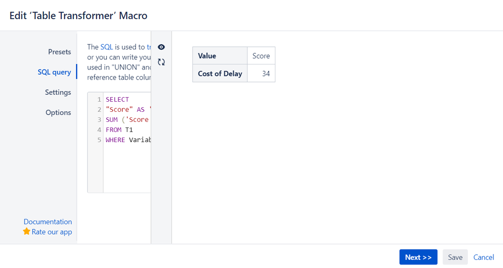

The internal Table Transformer macros are used for your original queries and ad additional line with future headers:
SELECT
"Score" AS 'Value',
SUM ('Score Value') AS 'Cost of Delay'
FROM T1
WHERE Variable IN ("Revenue", "Cost Savings", "Strategic Value", "Time Criticality")

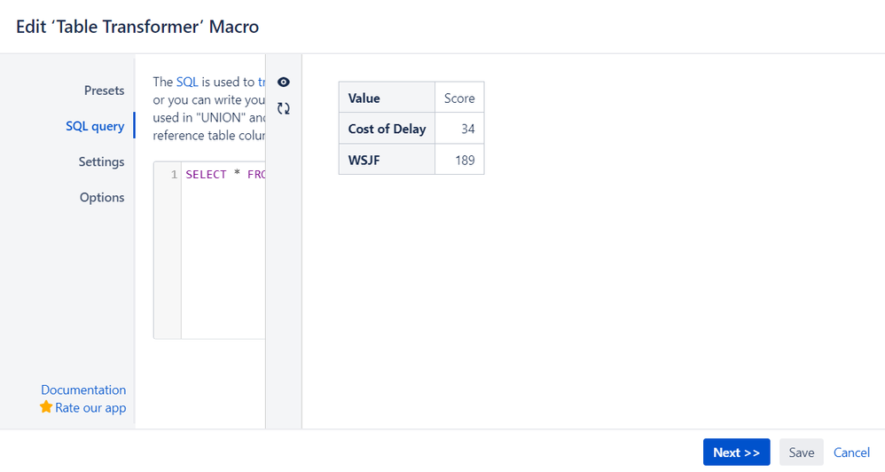

And we also use the Settings -> Transpose result table option to transpose tables for both Transformers.
The external Table Transformer macro is used simply to merge your result tables:
SELECT * FROM T*
