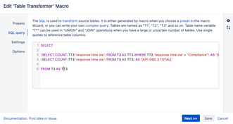

im struggling with a basic operation for counting the amount of values on a given column aiming to get the total value, however the result by using COUNT or SUM return weird data I don't understand the logic behind it.
Basically, I want to get the amount of repetitions of value "Compliance" I have for column 'response time sla'. The example below shows the correct number (i.e. "3") but instead of getting the result in a single cell, I got it as many rows the table has (i.e. "9"). This is the SQL im using:
SELECT
(SELECT COUNT(TT3.'response time sla') FROM T3 AS TT3 WHERE TT3.'response time sla' = "Compliance") AS '[KPI-DBE.3]',
(SELECT COUNT(TT3.'response time sla') FROM T3 AS TT3) AS '[KPI-DBE.3 TOTAL]',
FROM T3 AS TT3

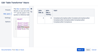

However, when im adding a new line to the SQL to get the SUM of all values on that column (by using "SUM" as an alternative to "COUNT") I got this:
What should be the right sentence to use to get just "3" or "9" for above queries?

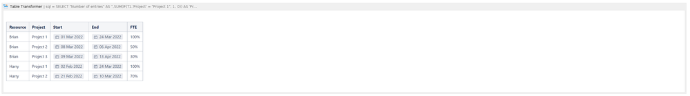

Hi @Esteban Borja Lopez ,
I can suggest using the following SQL query for the initial case:
SELECT "Number of entries" AS '',
SUM(IF(T1.'Project' = "Project 1", 1, 0)) AS 'Project 1',
SUM(IF(T1.'Project' = "Project 2", 1, 0)) AS 'Project 2',
SUM(IF(T1.'Project' = "Project 3", 1, 0)) AS 'Project 3'
FROM T1
And you may also check this Community thread for more details.
Don't forget that you may use the Pivot Table macro to count the number of entries with a more friendly UI (the unwanted rows can be filtered further).

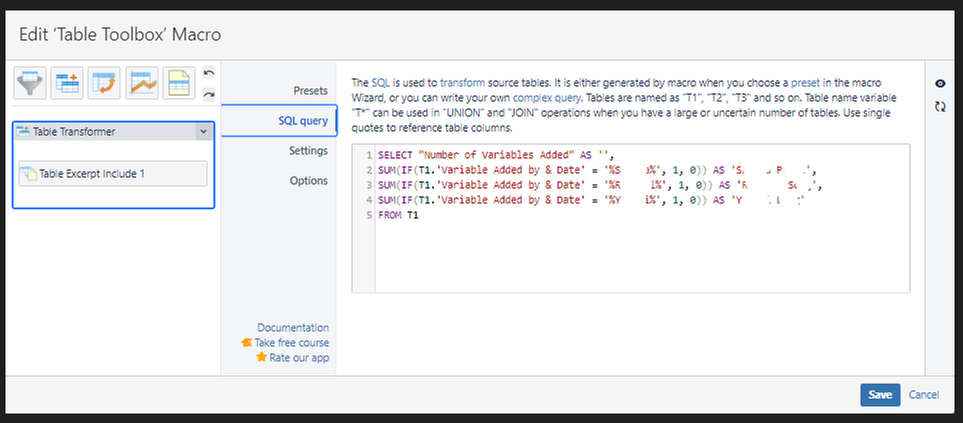

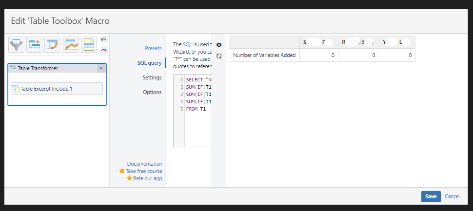

KUMIKO.PERCIVAL_EXT March 29, 2023
I am adding to this post as I have a similar need.
My team is using a table with the following column where a mention is included in the same cell as a date. Their preference is to not separate the date out into another column as the table is already getting pretty wide.
I am hoping to count the number of times a given user is mentioned across these column entries (ignoring the dates). So, I'm looking for a SUM IF 'Variable Added by & Date' contains a specific username.
The following SQL query isn't working for me (I realize that this may contain many errors as I am new to SQL). Is there a fix or an alternative approach that I could look into?
Thank you!
Stiltsoft support
March 29, 2023 edited
Hi @KUMIKO.PERCIVAL_EXT ,
Try to replace "=" by "LIKE" in your SQL query:
not SUM(IF(T1.'Mention' = "%John Smith%", 1, 0)) AS 'John Smith'
but SUM(IF(T1.'Mention' LIKE "%John Smith%", 1, 0)) AS 'John Smith'
Then your query should be working fine.
Like • 3 people like this
Thank you @Stiltsoft support, that worked perfectly!
