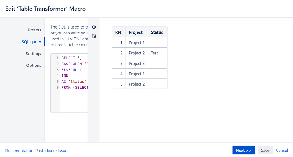

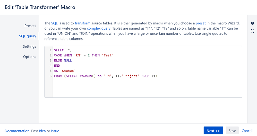

Hi @Karthika_Natarajan ,
You may try to nest the second query in the FROM destination of the first query. Here is an example for you:
SELECT *,
CASE WHEN 'RN' = 2 THEN "Test"
ELSE NULL
END
AS 'Status'
FROM (SELECT rownum() as 'RN', T1.'Project' FROM T1)
Hope this may help your case.

The query tries to look for the "RN" column in the first table but there is no this column at this stage, we add it in the end of the query.
My original example looks like that:
SELECT *,
ELSE NULL
END
AS 'Status'
