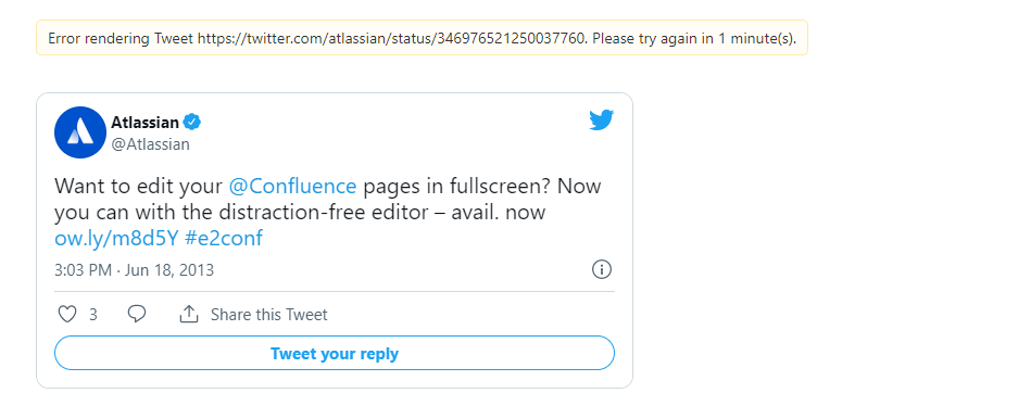

When we insert a twitter link into the widget connector, it shows this error:
Error rendering Tweet https://twitter.com/Atlassian/status/1418306581834440708. Please try again in 1 minute(s).

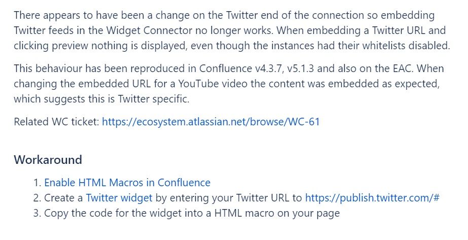

Hi @Dominic Lagger ,
Is it the same bug - https://jira.atlassian.com/browse/CONFSERVER-29639 ? There was a fix promoted on this as per 7.5.0 Release Notes - https://confluence.atlassian.com/doc/confluence-7-5-release-notes-1001823832.html.
Could you please check with this workaround ?

Hi  @Suvradip Paul
Thanks a lot!
With the HTML Macros it works fine. But We do not want to enable these macros. So we wait until the next LTS Release from Confluence.
