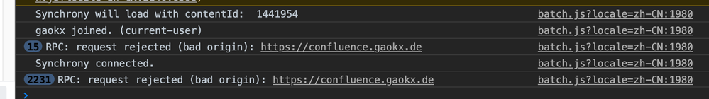

I get this error logs in console, if i don't close the editor dialog, the error nummber increased all the time, will not stoped. I post the screenshot and also my host url, it's the same domain, also the Server base url is the same.
can't understand why the error says bad origin.

qukankan August 17, 2020
Hi @Shannon S thx for your attention.
1. This is new installed Confluence, version 7.4.3.
2. Sometimes wenn i open a marco, the content will not show itself. Then i open Chrome console, want to see if some Request are failed, see the lot's of RPC: request rejected (bad origin) was printed.
3. My confluence is running behinde a Nginx. But i didn't get any error in nginx logs (acess.log and error.log).
Where can i upload the HAR file? I only find a insert photo button.
I notice, in chrome Incognito mode the error is not happen.
this is screenshot in Incognito mode, no error in console.
and this is normal mode:
Both was print from the same line: "batch.js?locale=en-US:1980". But they have different beheavior.
wenn i click the link, see this code with a nitification, maybe it can help to figure out what happend.
thx.

qukankan August 20, 2020
Sounds reasonable, but the problme is, the error was print from confluence script, exactly from this one:
After futher investigate (by disable each chrome plugin), i fund the conflict, which is Augury. This is a dev tools for Angular application.
But i can't understand why the "batch.js" print RPC Bad Origin error, wenn the Augury Plugin is enabled.
If we can get an reasonable explanation, this ticket can be closed.
Otherwise it means, some plugin in chrome can triger some function in Confluence Scripts?
Can it be a vulnerability?
Thx.
