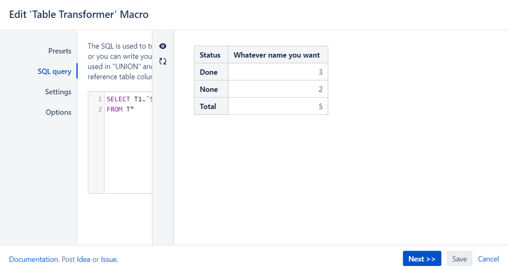

If you want to organize your result pivot table into a better way, you may rename its Operational type column - wrap your Pivot Table macro into the Table Transformer macro and use the following SQL query:
SELECT T1.'Status', T1.'Count' AS 'Whatever name you want'
FROM T*
If you don't want to show this column in the result table at all, just don't list it in you SQL query. For example, "SELECT T1.'Status' FROM T*" will publish only the first "Status" column.

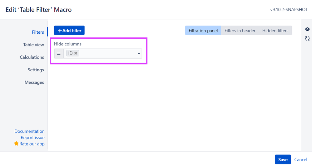

To rename the columns, you’ll need to wrap your Pivot Table macro in the Table Transformer macro.
On Confluence Server/Data Center you can do it directly and on Confluence Cloud you need the Table Toolbox macro to nest macros.
To hide unwanted columns, use the Table Filter macro on top. The “Hide column” option was moved to a different place in the new macro UI.
Please check the screenshot below:
Click on the Add filter button, choose the Hide columns filter type, and hit the Add button.
Now simply add the columns that you want to hide:
Hope it helps your case.
