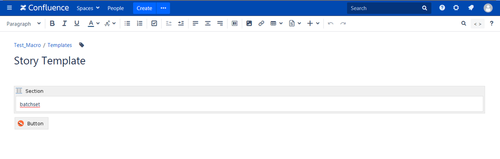

Sushma September 20, 2019
Hi @Jonny Carter @Carsten Hilber
I have a similar requirement, On clicking the "Button" it should trigger a REST api of jira Server and also it shoul send the body of entire page and  pageTitle.
is it possible to do that ?
I tried but, onclick() event is not triggering the REST API of jira
Please respond..
Thanks in advance
Sushma
Jonny Carter
September 20, 2019
@Sushma- easiest way to debug it will probably be to put some console.log("<message") statements into your code at various points to see where execution stops and why using your browser's developer console. I'd also recommend looking in your browser's network tab to see if the call to the REST API ever gets made, and if it returns an error.
That's the best advice I can give you. If you still need help, maybe post your own question with a detailed description of what you're trying to do, why, and what code you're using.
Sushma September 22, 2019 edited
Hi @Jonny Carter
In jira post function I have added the below code to achieve the page creation in confluence (using page template) from jira server.

In the above code ,I am passing 4 paramters:
1.page title
2.page template id
3.issue key
4. set of values that needs to be appear in the confluence page as checklist values (which is shown in the below screenshot)
To receive the above parameters I created the REST endpoint in confluence using the below script.

My template format is as shown below
here what i am doing is I am replacing the "batchset" value with the "body" which is received from Jira.
Using the above code I am successfully able create a page in confluence.

I am using script macro to create a button in confluence page.
On clicking the button it should call the REST api of jira server to update the existing confluence page with the new values .
