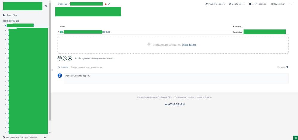

Hello everyone Guys, I have such a problem.
We made a data tree from a large excel file, which pulls the desired excel sheet from the general table and displays this information in the tab when you click on the name of the desired section. Data from one sheet should not be seen by users who see data from another sheet. I attach a sampleexm.jpg

I must administrate all department budgets. I've created the board (1, 2 scr). Now I have one problem: I cann't hide one depart budgets information from another depart users. I don't have privacy. How can I do it?

Ok, that's nothing to do with excel or even page trees in Confluence.
If you do not want a person or group to be able to see something, use "restrictions" on the page you want to hide.
Imagine you have Page A, with child pages Aa, Ab and Ac, and similarly page B with children Ba, Bb, and Bc.  The space permissions all say that Alice, Bob and Charlie can see the space and so pages within it.
Let's say Alice should only see the tree for A, and Bob the tree for B, and Charlie can see both.  Put a restriction on A that says "Alice and Charlie have view rights", and a restriction on B that says "Bob and Charlie have view rights".  The view restrictions cascade down to the child pages.
