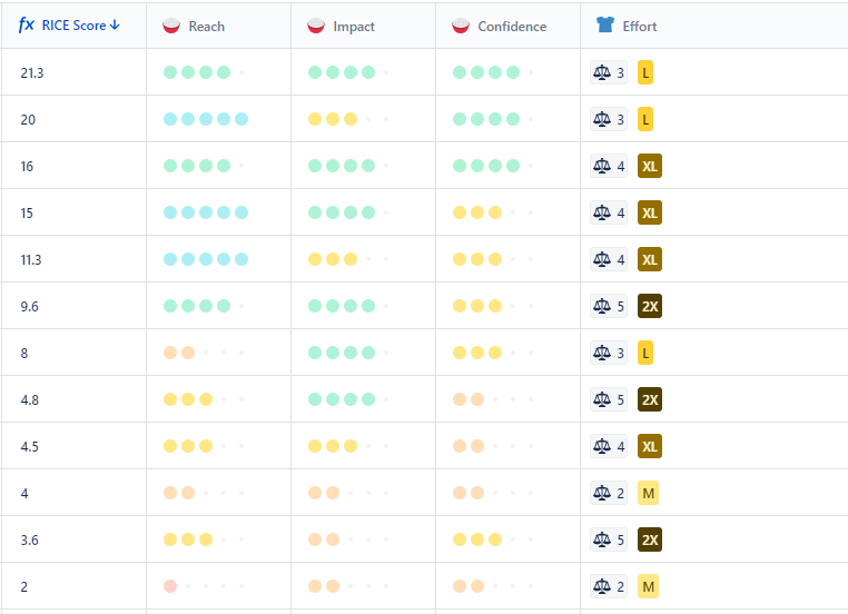

I've found success using custom expressions in the formulas like a RICE.   I'm not sure about using 3 dots but you could use a drop-down option and just weight them 1-3 to likely get the same effect.

@David Carnes comment is on point - and thanks for sharing screenshots that show how you can customize a Jira Product Discovery project !
1. You can create as many impacts as you need by creating new fields
2. The Rating field has 5 dots, but you can use a multi-select field instead to only have 3 options
3. You can remove and add any fields from the existing calculation which is more of an example, and you can create your own calculations
