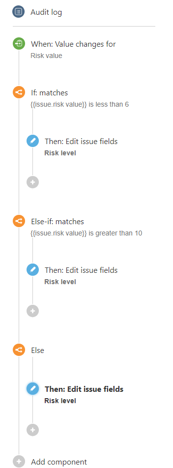

Hi @Krishtee  I understand you try to accomplish this using a post function. I see two obstacles here
  • What if you want to change the Risk value without transition the issue?
  • As I understand it, to support this approach you will need this script included in every transition you want to align Risk level with Risk value.
Suggesting another approach
I might suggest using Automation to set Risk level based on Risk value. The automation example below should update Risk level, and also constantly maintain it correctly.
Don't have Automation for Jira?
If you don't have Automation installed I would recommend you get it because it really boost Jira to another level.  Automation for Jira is free. It is still downloadable for server
TimK.

Tim Kopperud
October 22, 2023
Hi @Krishtee, That was strange.
I tested the rule using the Issue created trigger. The rule now looks like this:
The newly created issue was updated as shown below:
So, it works as expected.
Can you attach an image of your rule? And an image of the the entry in the Audit log? It will be helpfull for further investigation of why it doesn't update the Risk Level on "your side".
TimK.
