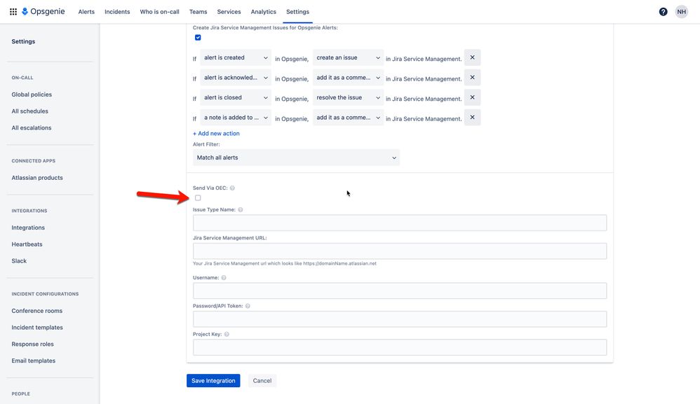

Typically when the alert's activity log shows "Sent [createIssue] action to JiraServiceDesk" it does not create the ticket in Jira" - but no issue is being created in JSM, you have the OEC checkbox selected:
If that's the case, please unselect this, save the integration, and retest. OEC is typically only needed with on-prem instances: https://support.atlassian.com/opsgenie/docs/integrate-opsgenie-with-jira-service-management/#Integration-via-OEC--for-On-Premise-Jira-Service-Management-Usage-

Then I believe OEC would be required with your instance, and that checkbox would need to be selected.
With this, you would install the OEC service on a server (typically on the JSM server), and it will sit in the middle of Opsgenie and JSM. Opsgenie alerts would send to OEC, which will then execute a script to create the issue in JSM.
You can modify the OEC script to customize things such as configure it to set an Opsgenie alert field as a required custom field in JSM. But it seems like it'd be needed for your use case.
