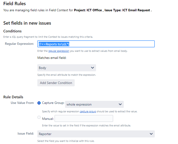

I want to update this post with a resolution.
The solution was to use the app "Email this issue" which we luckily had installed.
By setting Field rules as shown below, I can now auto populate the Reporter field from the incoming email body text.

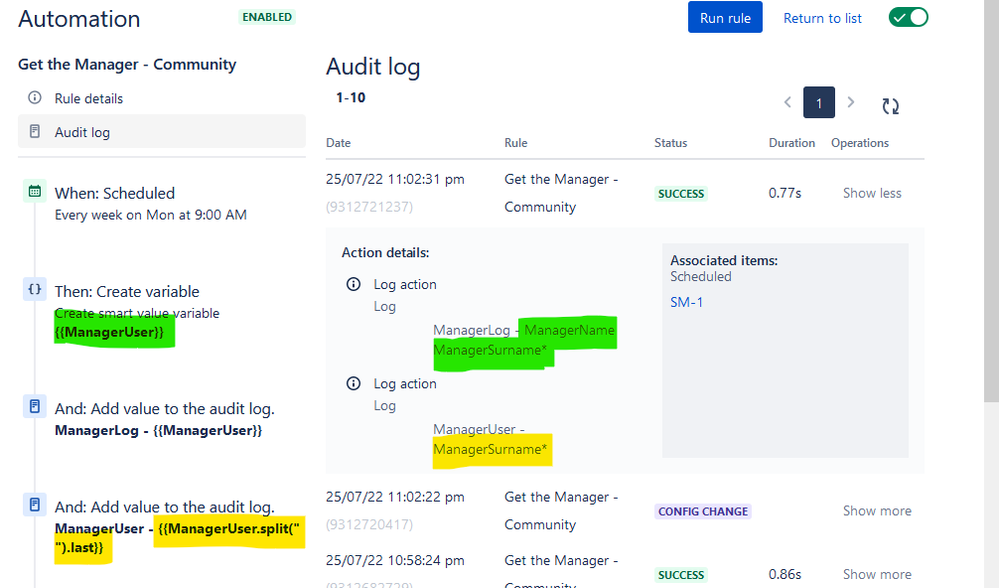

To performed something like this, you will need to split the pattern that you got from this
{{issue.description.match("Reports to:\s(.*)")}}
To this
{{{{issue.description.match("Reports to:\s(.*)").split(" ").last}}}}
Or if you want you can create variables in automation to deal with the values more easier.
I assumed the pattern being "FullName Username"
Then assignee the value that you need with the functions to treat your text.
