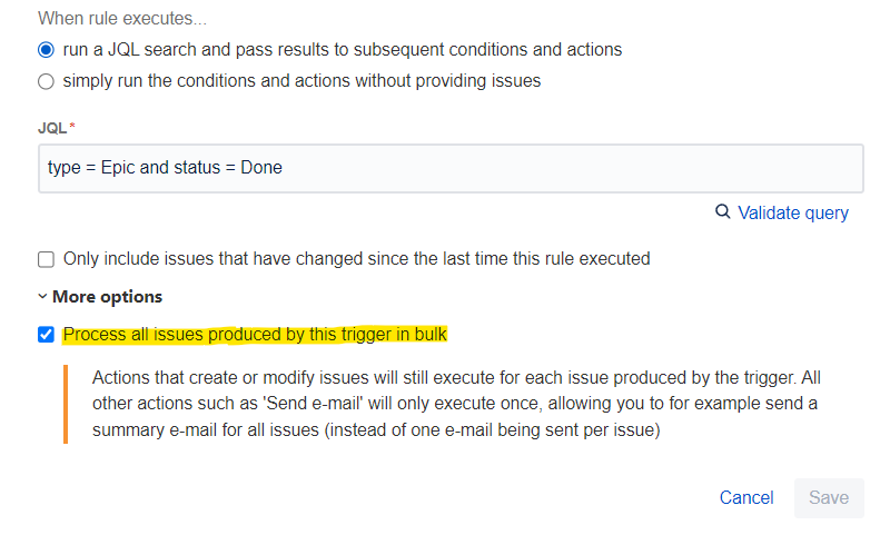

{{issues.size}} can be used either with the trigger Incoming Webhook or the trigger Scheduled. Check out more info here in the documentation.
Here's the example of the rule:

@Krishtee, my bad for not mentioning to select Process all issues produced by this trigger in bulk.
Try to run the rule once more with this option enabled:

@Kseniia Trushnikova
Thanks for the help.
It works as expected.

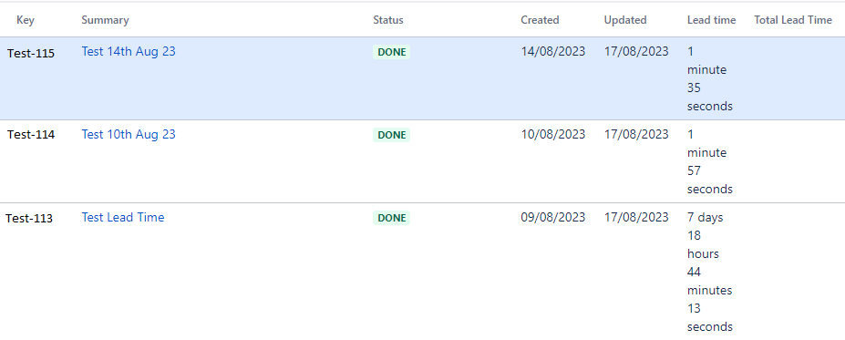

I have a custom field "Lead time", where i'm calculating the difference between field Created and Updated.
Please find below my automation:
This rule works correctly and is outputting the result in my dashboard:
Next, I want to calculate the sum of all the values from field Lead time. For that, I have created another custom field "Total Lead Time".
For example: Total Lead Time = 1 minute 35 seconds + 1 minute 57 seconds + 7 days 18 hours 44 minutes 13 seconds
My automation is as follows:
But, when this rule is trigerred, I'm not getting any result in the dashboard (column Total Lead Time).
Can you please advise what is wrong?
Thanks.

I'm not sure if it's even possible to sum up such values. {{issue.created.diff(issue.updated)}} returns a string, but only numbers can be summed up.
Anyway, I'd recommend you to create another question so other community users can advise you on it.

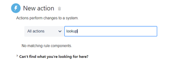

To calculate the number of tickets you have to run a jql query inside the rule with lookup issues action and then use smart value {{lookupIssues.size}}.

Krishtee
August 11, 2023
Hi @Alisa Zamaraeva
Thanks for helping.
Can you please advise how to proceed?
Kseniia Trushnikova
August 11, 2023
@Alisa Zamaraeva, it looks like @Krishtee's using Jira Server/Data Center. Lookup issues is available only for Jira Cloud.
