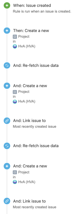

With an Automation for Jira rule, 3 new issues are created when creating 1 specific issue.
These 3 issues are linked to the trigger issue.
But now I also want the 3 issues to be linked to each other.
How do I get this done?
Regards, Marco

Hey @Marco Brundel
This sounds easy but is a little complicated. I found one way to do it, someone else might be able to suggest a simpler way.
The rule needs to run sequentially so using branches isn't possible, we also need to refetch the trigger issue a few times.
Here's the rule and I'll explain some of it below.

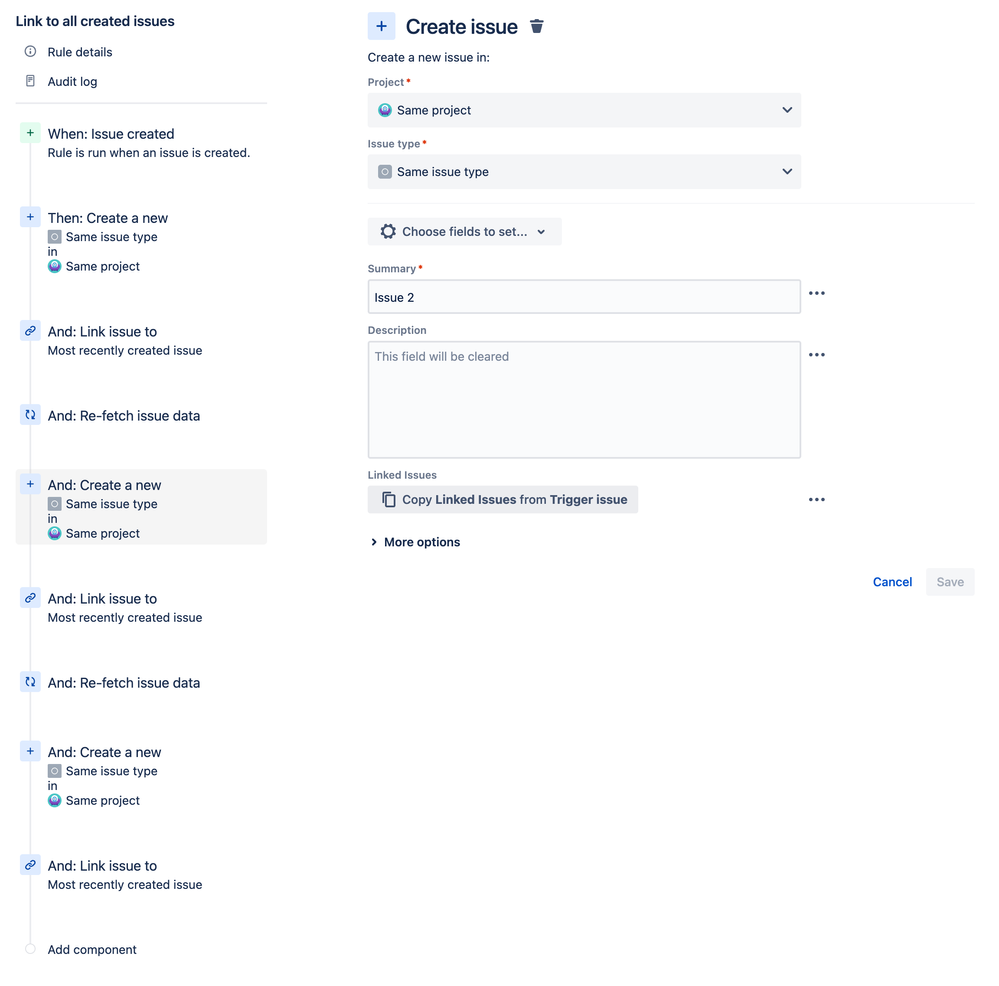

  • Rule triggers when an issue is created (add a condition after the trigger if you only want it to trigger for certain issue create scenarios)
  • Create issue
  • Link issue - Set the second select to "Most recently created issue". This links the recently created issue with the trigger issue.
  • Re-fetch issue data - Now the rule can see the new issue link
  • Create issue - important in the choose filed to set dropdown add "linked issues". Use the ... button to switch to "Copy from" and set the linked issue to "Copy linked issue from trigger issue"
  • Link issue - Same as the previous one
  • Create issue - again copy the linked issue field from trigger issue
  • Link issue to most recently created
The trick is once you create an issue link to refetch the issue so that you can then copy that link in the next issue you create. So issue 2 and 3 copy the existing issue links from the previous actions.
I'd also suggest using relates to as your link type. I didn't try with other link types because they have an inbound / outbound version (e.g. Blocks and Blocked by).
Hope that helps!

Marco Brundel
October 8, 2021
Hi @JD ,
Thank you. You just gave me the right tip and now I have the rule working. Only with the 1st create I don't do a create action. Thanks again.
Regards, Marco
